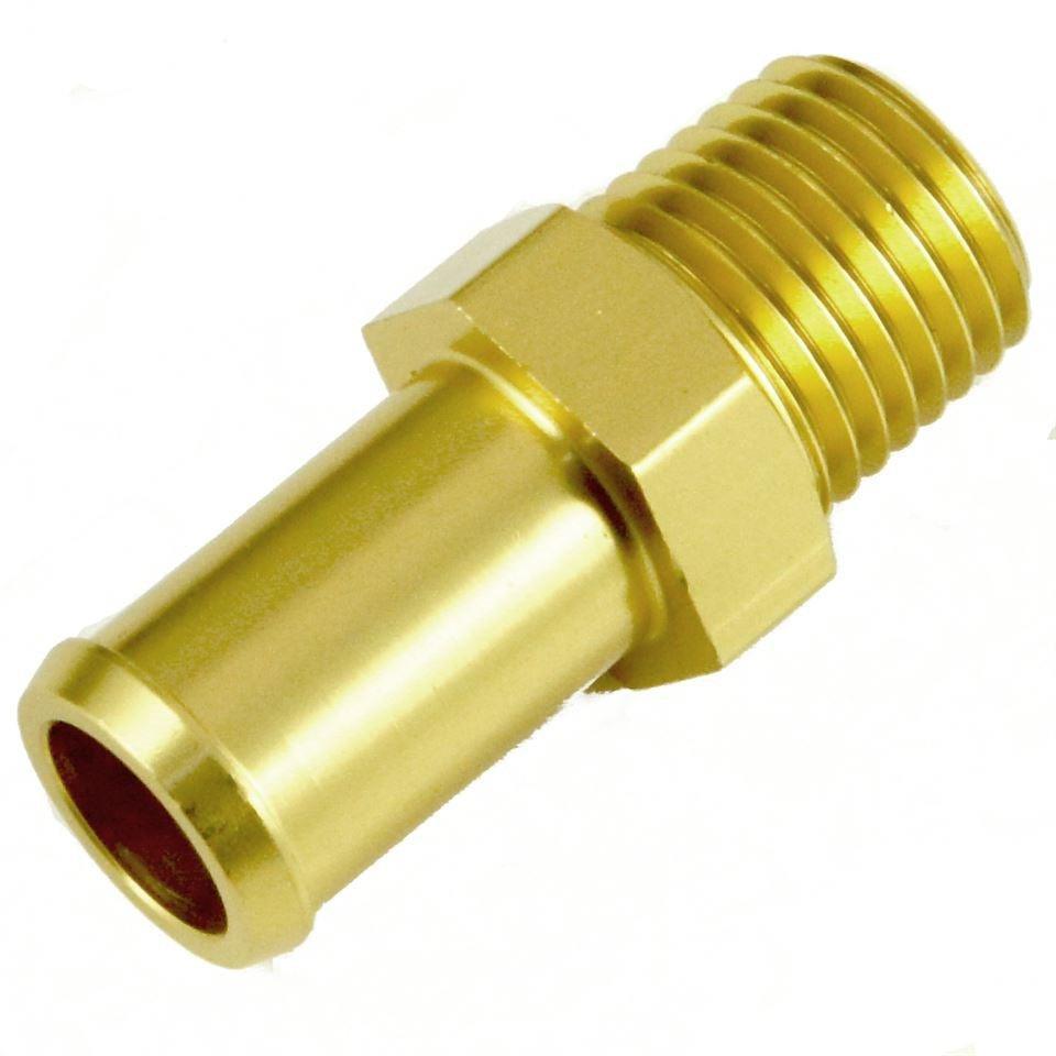

Ah so you ate thinking of converting the ends to barbed type connections and use a jubilee clip?
There is around 40psi from the pump, is this safe? I do see alot of people doing it, but that may have been on carbed vehicles.
Even if you go this route as a temp just to get car running it buys you time to get metal pipe made or ordered.
