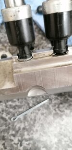

Found a nice way round it. Only 2 had failed. Used a split pin. Pictured the proper clip.
Modified split pin became the perfect size in both width and thickness.
It does mean to change that injector in future its fuel rail off, but I'm happy with that.
