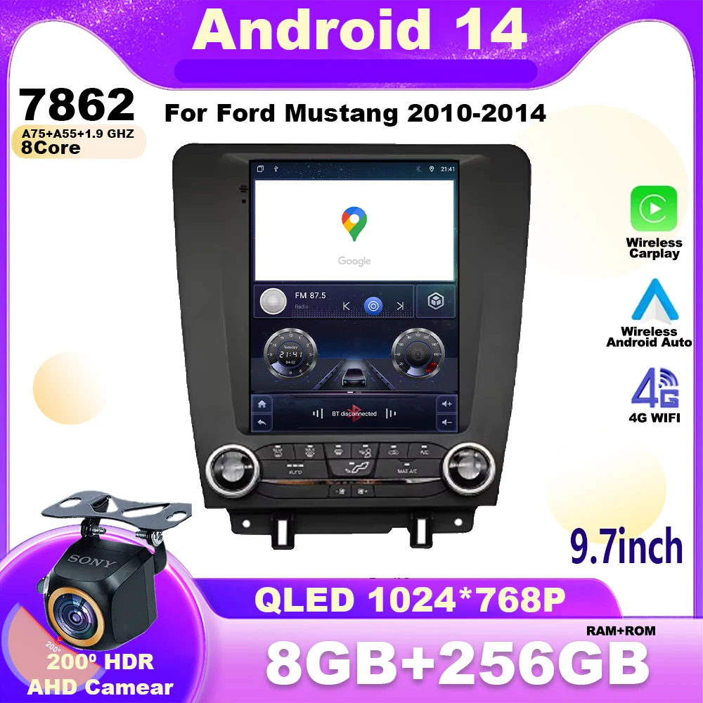

Not done anything yet, but have a long list. Starting (for simplicity reasons) with the radio.
Has anyone dealt with the chinese Android units? I'm looking at this:
My boss has bought units from AliExpress for his old Range Rover and his current Porsche and says they work great. The only thing I want to add to it is DAB radio - anyone know how easy/impossible that is?
On the 5th gen mustang you have to modify a bit of wiring. Can't make out what gen your mustang is you might just need to buy the correct plug and play adaptor harness keep thread updated with this others might need help as well 👍
